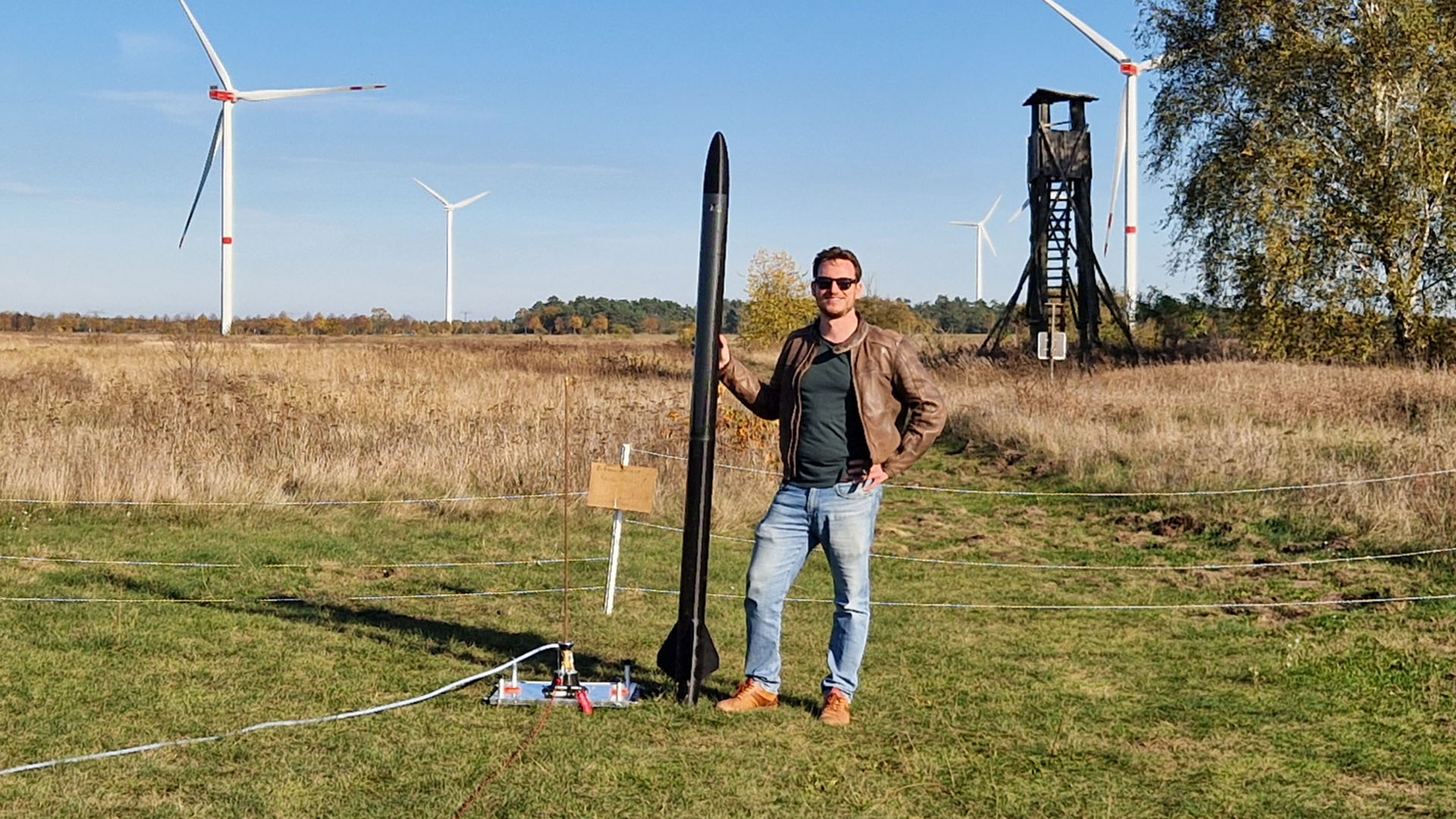

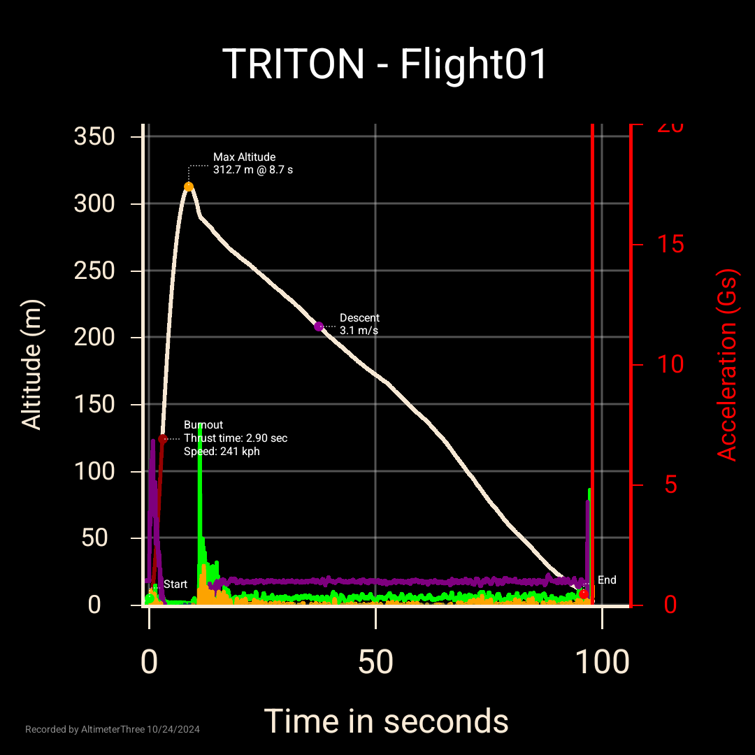

Hallo allerseits!
Es gibt einen Neuen Deutschen Rekord: 312m. : )
Video: https://youtu.be/RhrX7mGevno
TRITON
Flight #01 24.10.2024 15:00 CEST
Wind 9kts 107° ESE
Temperature 15°C
Type Water Rocket
Body Diameter 100.6 mm
Length 2220 mm
Dry Mass 1920 g
Launch Mass 5120 g
Capacity 11.44 l
Nozzle Bore 10.0 mm
Drag Coefficient 0.402 cd
Stability 2.27 cal / 10.8%
Max. Pressure 25 bar / 363 psi
Flight Pressure 20 bar / 290 psi
Peak Thrust 305 N
Total Impulse 396 Ns
Burn Time 2.9 s
Max. Velocity 67 m/s / 241 kp/h
Recovery System Automatic Parachute Deployment
(Barometric Apogee Detection)
Parachute 1600 mm Octagon
Electronics/Sensors GPS, Altimeter,
3D-Accelerometer, 4k Camera
